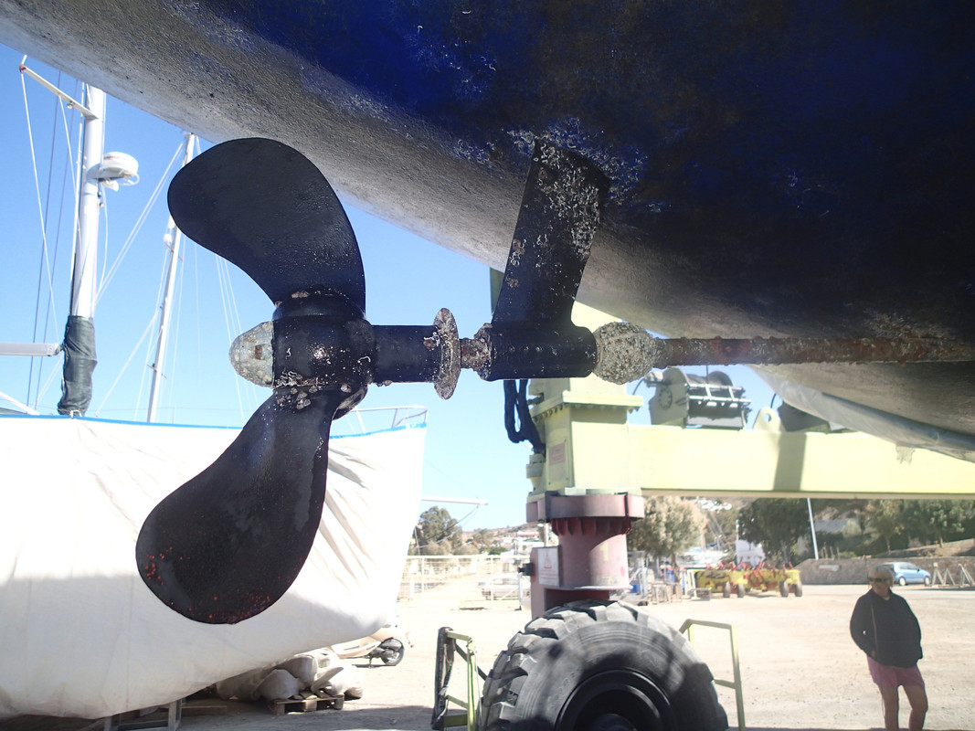

Your description sounds like tubeworm. Is this in Cornwall? A major problem in the Mediterranean, where it is probably the worst fouling type. As Jonathan suggests abrade with fairly coarse papers, wet and dry should work underwater.
At haul out Velox offers the best protection against tubeworm, although not perfect. I suggest that Hammerite Special Metals primer is better than Velox' own. I have posted often on this so a search will find it.
Here is a pic of my prop with this treatment after 5 months afloat.
