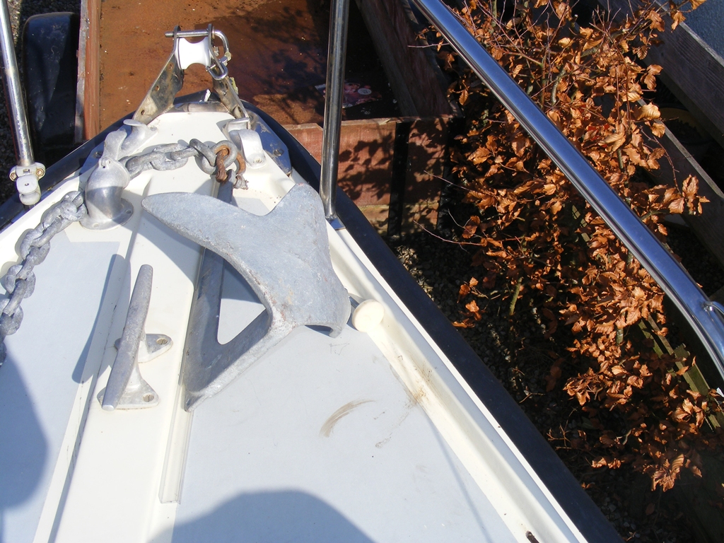

Anchoring has been a chore as until now the anchor lived in a stern locker and had to be carried forward for use.
I want to stow the anchor on the deck so it's ready for use.
this gives an idea of how I would like it to be secured:
The question is how to secure it there?
I think I need 2 "clamps" of some sort that will hold the shank down securely.
I will also need a pad under where one of the points touches the deck. I have a possible candidate for that lying on the deck next to the anchor that can simply be bolted there to give it a pad to rest on.
Any ideas?
This can't be such an unusual thing to want to do so is a suitable "clamp" available off the shelf?

I think I have found a solution:
It fits between the two front pushpit poles nicely and strapped on with a couple of sail ties it's as solid as a rock.
It doesn't interfere with use of the bow roller in the harbour and no part of the anchor extends beyond the edge of the boat.
The only slightly fiddly thing when stowing it is threading the shank under the furling line but I've tried it a couple of times and it's quite easy.
