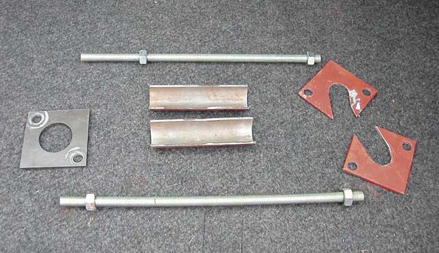

In case it may be of any use to anyone, I removed the cutless bearing from my boat recently and felt chuffed with myself for doing so.
I didn't fancy the prospect of paying the yard to do it or buy a purpose made remover. I really didn't want to attempt to do it myself until I had a good look at what I had to hand in my shed.
I had a bearing puller, I asked a local scaffold company for a short piece of pipe and sent away for a 'cut to size' disc of 6mm thick mild steel (£3.00). I added a few plates to add length to the puller's reach and then put it all in place.
The cutless bearing was 1 1/8" x 1 5/8" x 4 1/2" so the 40mm steel disc (which i reduced to 39mm) covered the end of the bearing but was smaller by a few mm to fit inside the 'P' bracket hole. Grip was a problem at the other end so I cut a piece of scaffold pipe and opened it out a bit so that the cutless bearing would pass through.
Having taken out the grub nuts either side, I turned the bearing bolt and slowly out popped the bearing!
Phew!

DIY cutless bearing extractor - Practical Boat Owner
Good job
This is a DIY one made by a forum member
