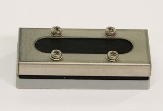

I have one of these
from that page, which formerly had GPS and radar detector leads and now has GPS and AIS VHF leads. Works nicely, and lots of room to get a plug through.
