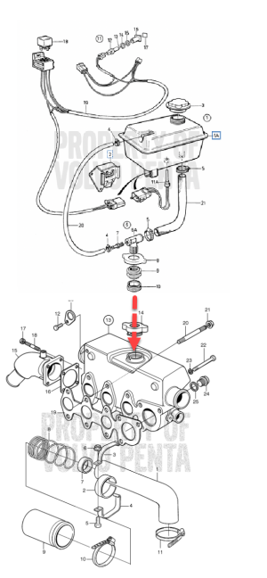

NO, you put a plain cap on it, not a pressure cap. I fail to understand why you have 2 connections to an expansion bottle, you only need one at the bottom, it will still vent air.

There is no small outlet tube on the above diagram, perhaps that is why that complex system is used. As the OP has a small tube on his system surely that could be used and would solve all the problems, once the flange is resoldered of course!
