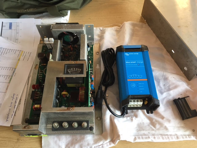

I just replaced the old charger in my Sealine S24. with a Victron 12/15 3 output Bluetooth. It is a third the weight of the old one and about a third the size
Mind you the old one is in my opinion an electronics work of art. I will clean it up and mount it to the wall of my office as a piece of art
