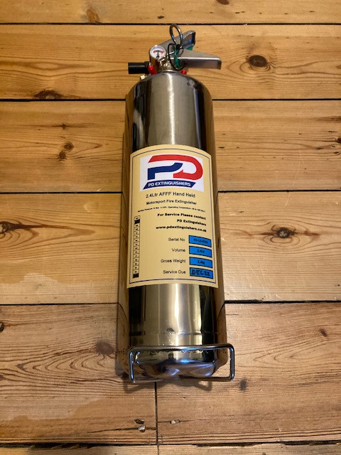

If you do choose to have a large-ish (2.4L) AFFF extinguisher on the boat - which is also specified to -20°C - it helps if it looks like this! ?
All stainless and very nice indeed. Everything feels 'quality' compared to what's on the boat already, even the bracket.
