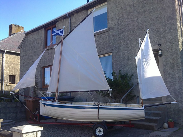

I have some dacron offcuts from when I made the sails that I can try dying tan and see what happens. If not, I have to make some new sails for her. Luckily, its only the wee jib thats affected, and it was only made cos I was bored anyway. See photo:-

Im either going to have to make a new jib, or just forget the whole bowsprit/jib idea. I do have enough Dacron left to make another jib for her if needed.
It sails just fine with just the main and mizzen. It needs the mizzen for balance though. Keeps her head up into the wind nicely.
