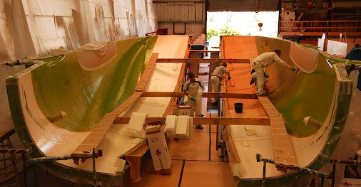

There are a couple of photos of Northshore's lay-up process in this blog - https://distantshores.ca/boatblog_files/moulding-the-hull-s49.php Note the rather precarious use of planks as a working platform. Note the buckets of resin. Note the open door on the building, so climate control wasn't deemed important. And this was less than 10 years ago.
Whistles thoughtfully. A quarter of a million secondhand, eh? Still, it looks a lot better than the Norfolk shed where Oyster had their hulls built.
