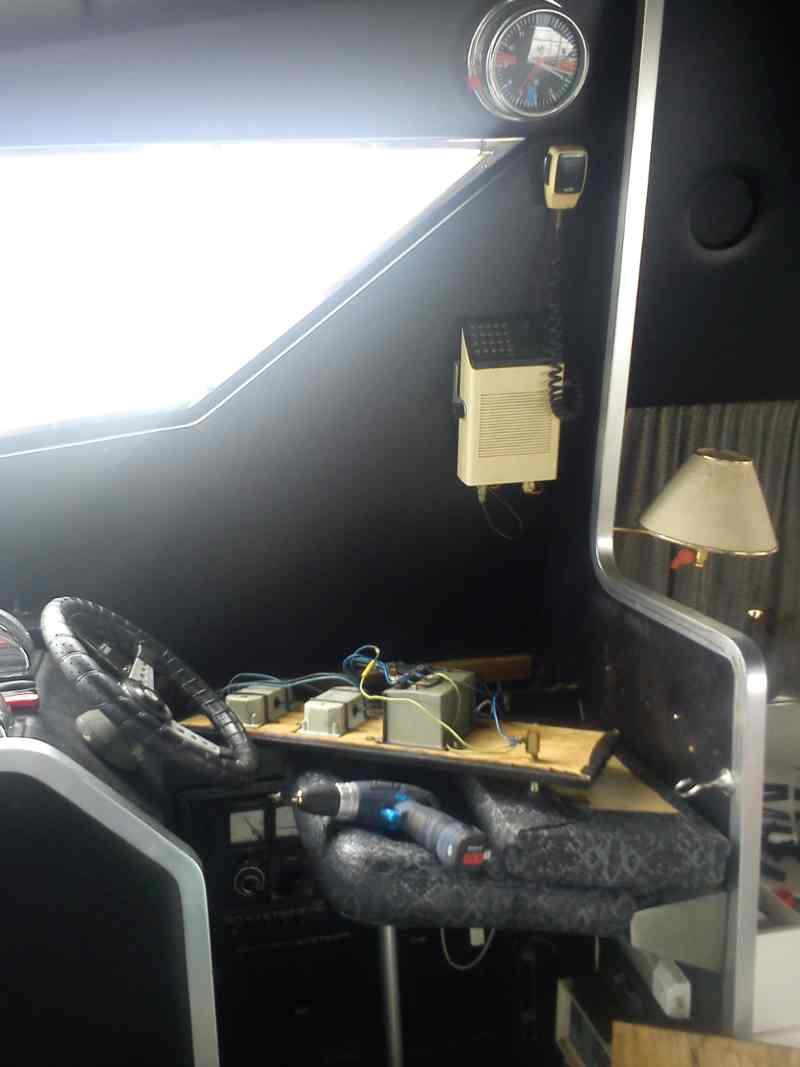

Weather much better, rib hurts less, so dismantled the rest of the helm bits that I need to redo.
The slanted one where I'll fit the keys/stop buttons for the ivecos and the Cetrek autopilot control.

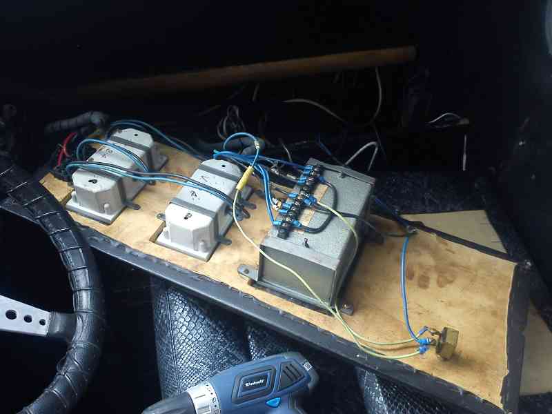

The horizontal one aft which will get the two wiper controllers one next to the other (they fit nicely!) and the rear part I'll built a extra elboard box (up to about where the VHF now lives) for my BMS and few more controllers (bilge/black water pumps, etc) That's going to be slightly narrower and wont interfere with helming
So it now looks like this:

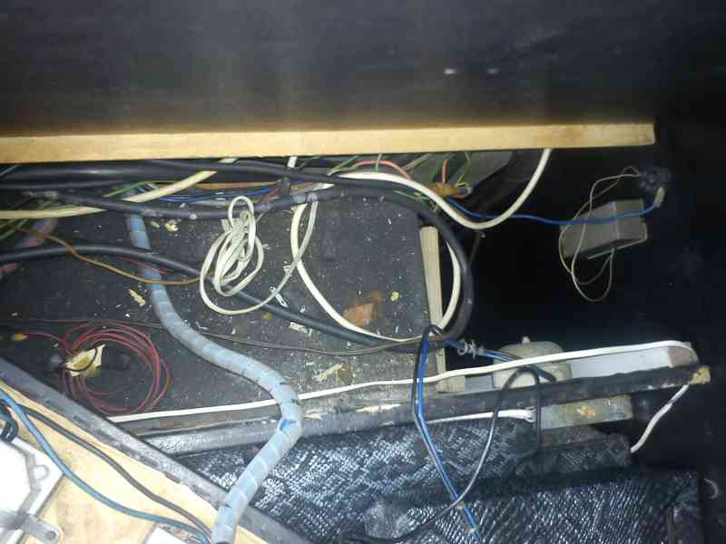

There's a MASS of tangled wires in there, there's the nicely organised detroit related ones (that I cut and tape) and the rest that I'll have to spend a few days figuring out what does what...
Thinking of REMOVING completely the bunch that relate to the detroits. Any reason not to? Other than not finding the route and having problems pulling them about that is...

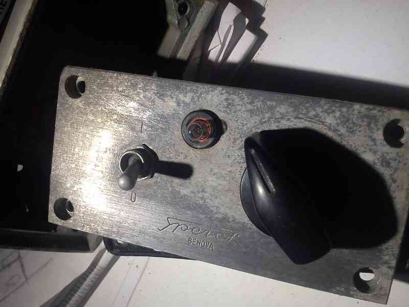

The Speich controllers is a beautifully engineered piece of kit from the 70ies:
Plan is to lasercut a new plate on which both boxes will be secured and probably swap the small indicator bulbs to leds since the red warning cover on the one is missing :(

aha,
thats what I had in mind of what could be in there;
a old power / wire winding potentiometer,
so the button on top is not out of proportion with its function.
nice :-)
yep exactly, so now I have to handle this beauty with due respect and design a proper front plate for them. To tell you the truth I feel bad about replacing the small indicator bulb/assembly with a 5mm red led + resistor :(

They used to be off-white, with black writing and a slim black coned semi-circle for the black dial for the speed, moving from left to right in 180 degrees over the top (through 90 ).
