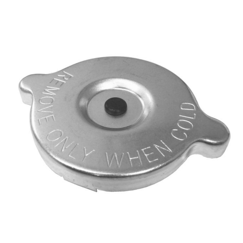

I went to a scrap year and got one from a mini of BMC 1100 1300 and other BMC cars as I was used to those cars
The cap on the heat exchanger is like this
The pressure cat I took off the heat exchanger when on to the expansion tank
OIP.ksQ4Em4lRw4kQ0htrwMvxAHaHa
Or
R.2dc16784fd8f3e3b8851d0b517ce54e0
OIP.swDgZPVLEk9IycexsnUv2gAAAA
Plus a plastic bottle to catch any overflow
