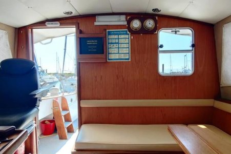

Potential purchase of small yacht on hold as wife doesn’t like odd shiney headlining.Wa thinking of taking down and possibly glueing thin batterns direct to the GRP then say four mil ply fixed to them but what non toxic adhesive would be effective
pink grip made by evostick works very well for sticking wood to fiberglass and
it dose not cost a fortune. re done mine with it .
