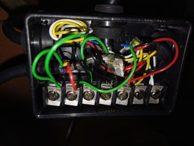

My B&G system has a port and stbd speed log setup ... which had switches and apparently auto setup .. to determine which supplied data to display.
I have disconnected the multitude of wires from the mystery blue box which may have been the auto side of it ... it is still connected to the B&G #7 Junction box ...
The #7 box appears to have the transducer cables enter and then a cable goes to the 'Blue Box' ... with possible feed back into the #7 for data out to the display ??
I am of a mind to remove one of the speed logs and just stay with one .. as they are very close to keel line ahead of the actual keel.
The problem is >
As I note - there is nothing in the box - just a line of terminals ...... its going to be a nightmare to decide which / what to disconnect ... I just pray that removing one set of multi's black cable will be OK ..
The problem is >

Easier said than done ... its identifying the cables ....
The 'Blue box' which I suspect is the auto switching unit .... is now not connected fully - so maybe no transducer is going to feed into display ??? Only way to find out is pull transducers and spin by hand ... or go for a sail !!
That's a good system, and I would preserve it if I were you.
Do you have any kind of sailing computer in that setup, maybe an old Hydra or Hornet?
The old B&G logs had a tilt switch which would switch you over to the lee side transducer when the boat heeled. A very simple, reliable and good system.
If you don't calibrate your logs much then you might not notice, but the windward side transducer will always under-read when there's more than a certain amount of heel, even if they are pretty close to the centreline. This will throw off your true wind and your laylines. Your system is a very effective way to solve that.
Sailing Computer as you put it - may be that 'blue box' .. it has orientation arrows scribed onto the case ...
But tbh - I just want to be rid of the tangled mess ... I'm not bothered about a % here or there about speed ... my pal and I both have bad backs and decided that racing may be a thing in our past ...
Would be nice to get the wind / tactic displaying correctly though ... which I think is being affected by the mess installed.

The only interaction without change-over switch - would be the pulses of each would be out of synch .. possibly be regarded as faster due to the increased number of pulses seen ? But most likely - speed would not show due to interference of one to the other.
Brings me back to manual switch ? Hopefully its only the NMEA wire that needs switching...... once I identify the two tranducer cables !
And why did the 'Blue box' have connection to the analogue KNOT meters .. one in switch panel and other in hatch garage ??

Tactic ... display ... my B&G has two wind displays ... the full 360 deg WIND and the 60 deg TACTIC ...
As a trained ships navigator originally - vector diagrams and all that are old hat to me ...
But if I can get one 'ducer' talking to the Network without interference from the other - I stand a chance of the WIND displays behaving themselves.

Are the two speed logs interfering with each other? If so, that should be easy to fix. It's just simple wiring and a tilt switch.
Are you talking about displaying true wind, or apparent? If you're talking about apparent, then you need need any kind of speed data, good, bad or otherwise, for that -- apparent wind is directly measured.
True wind is the challenge. That's how you determine a layline, that's how you know how close to DDW you can go, that's how you know what the wind will be like after you make a turn, etc. etc.
If you care about any of that at all, then you really want as good STW data as you can get.
