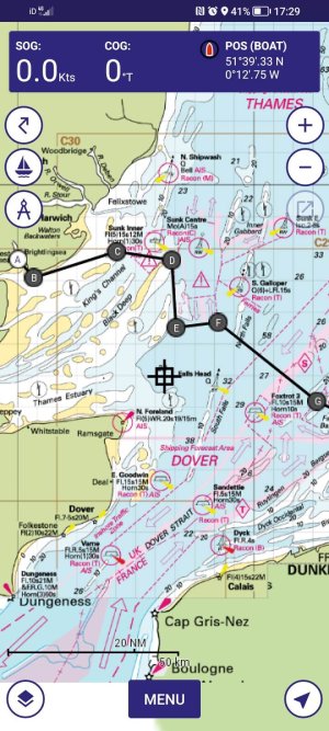

Hi,
hoping to make this crossing for the first time in a few weeks time.
I think I read someone here advising that it's fine to cross the Sunk Centre shipping 'roundabout' ie to go pretty straight from d to F on this image.
Is that right?
Or do I need to follow the recommended route?
Many thanks,
Crisp

I just came though there on Tuesday.
I follow my plotted route ignoring the whole set-up unless there is any shipping using the area.
If there is I alter course to keep out of their way.
It can be challenging to work out where they are planning to exit the roundabout.
I do have AIS on the Plotter which does give a better idea of what they are up to.

monitor sunk vts as you pass through. They called us up once as a cruise ship was coming through the gyratory and they asked our intentions, advised us of the traffic situation and we agreed how we'd all stay clear of each other. They did not chide us for crossing the roundabout - just v professional and helpful...

Channel 14. Sunk VTS have radar coverage of the whole area. They'll call you as "the vessel to the south storm of the dynamo buoy" or something like that. With all the ships about and the pilot vessels back and forth through there they'll find a way to get in contact with you. Pilot boats often go pass messages to yachts to contact sunk VTS on 14.

Just been across and back for a 3 week trip to .NL and passed straight through Sunk precautionary area in both directions. The key thing is to use VHF Ch.14 and AIS if you have it.
On the way out, I was in convoy with another yacht and VTS called them. The other yacht could not actually hear the VTS so I engaged. They wanted to ensure we knew there was a large vessel approaching from the south. I had it on AIS for an hour before and called back saying we knew exactly what the situation was and confirmed our plans to keep clear.
On the way back, I heard various vessels checking in with VTS as they approached the area and made note of their destination so I knew which direction they would be turning. One vessel I was unsure of so preemptively called VTS and they were able to tell me the other vessel was heading to Sunk inner anchorage so I knew to slow down and tweak to stbd before they even started to turn west and I reported that I would do so to the VTS.
The main thing is proactively use VHF 14 as a tool, don't just tune in as a tick-box exercise... Listen to the VTS talking to other vessels, not just you.
VTS are happy for to cut straight across, they just want to know your are alert to what is going on.
AIS was useful, my chart plotter does CPA calculations and I knew an 30min or more before what my passing distance would be in the precautionary area. Also useful in the TSS which seemed empty as I approached it but there were vessels 20NM away doing 20kts and visibility was only 10NM. Calculated CPA predicted I would be 0.5NM off their rear quarter an hour later and it was pretty much spot on.
