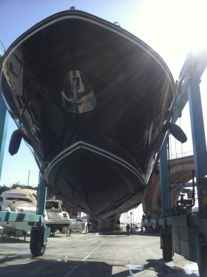

What I can show him is how it’s done a 23 degree deadrise .
Put it in the centre of the V as far Fwds as practical.

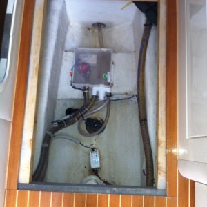

Itama cut a flat pad in the Vee a notch .So it’s irrelevant what the angle is .
They cut away some of the sold hull from the inside to flatten out a pad .^
It’s in front of the bilge switch btw ^ .
Just make out a notch in I i front of the strap .^
Again in front of the strap .

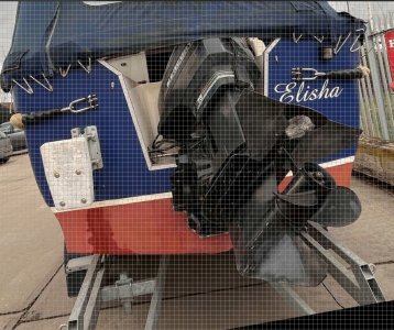

From looking at the Family Pilot 20 as a prospective purchase, the deadrise is quite shallow at about 10° estimated. It has been about a year since I looked at one out the water.

Looking through my archives found this pic, rotated it 10° to the left
