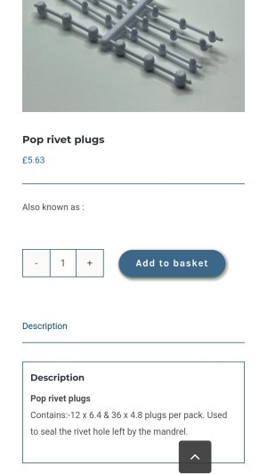

The plastic in the centre of the pop rivet that drilled like plastic probably was plastic..
After pushing the steel central mandrel out (or in, because it would rust), a rivet plug was probably put in its place..
Pop rivet plugs
On reflection I think you're right. So no mystery. Likely the cotter pin hole was epoxy and the rivet *was* a plastic rivet plug.
