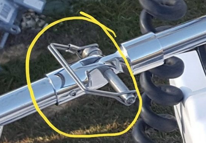

Sheridan have "Stainless steel inline tube connector for joining two tubes together providing a telescopic function to rails with a thumb screw locking and release stud." But I can't see how that would work:
Stainless Steel Telescopic Tube Connectors

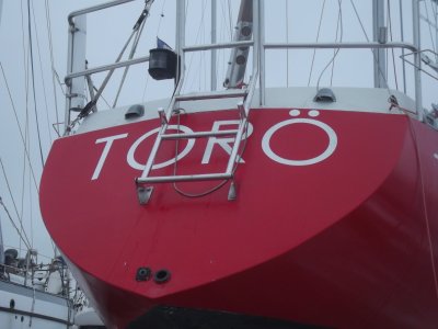

How does the gate lock? With the vane gear I'd imagine there's a lot of force there.
I have 2 pins that slide down the ingles on each side and remove the one pin to allow the gate to swing out of the way entry and exit which also moves the self steering gear out of the way
The self steering gear can also be removed when not needed
Gate open above, closed pictured above

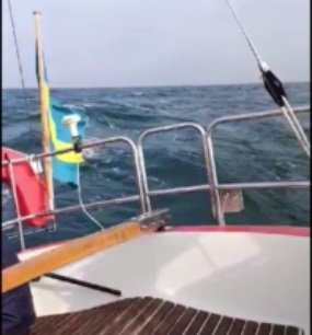

You missed out the top section in your pic. Reminds me of my mother's photography ... heads missing.
Photo was from my archive - not taken for this thread. The top section has nothing special at all .. no fastening / bolt / clip ... the 'ladder' pulls up and and then is tied off with the lanyard ... more than enough to stop anyone falling through.
Just extracted 'snapshot' from a video showing under sail and ladder closed up ... no chains ... no wires ... no clips or bolts ...

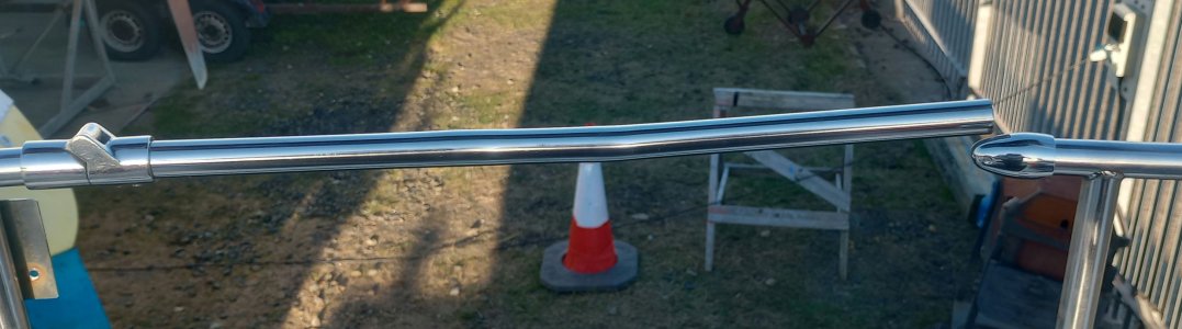

In middle of doing this. Forgot to bring an end piece with me. Will tack weld, I think.
