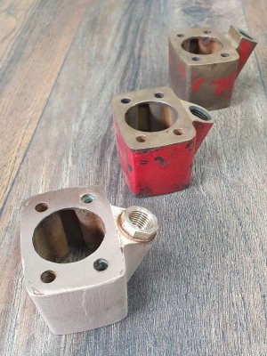

Great advice from Tw Marine regarding replacement temperature senders for Bukh dv20 .
Rhylsailer99
19 Jun 2020
717
Note the picture and you will see some blocks have a raised insert, and this is what you need to install the 2 prong type from furneaux riddall.
Installing the 2 prong type on the middle block in the picture will cause it to crack and fail fast, as the block is not deep enough to take the sender.
