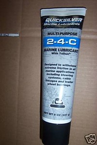

WD40 have no real lubing properties.
According to the manufacturer of your engine water resistant grease is way to go. Any will do, Merc's own (Quicksilver) is with Teflon
Can be used for all moving parts, cables etc.
