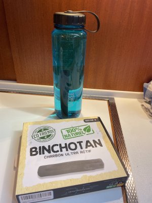

I ordered simple Nalgene water bottle and Bincho-Charcoal. If it doesn’t work, we’ll try Finerfilters kit system as well. I bookmarked it on Amazon :)

Yes all about making it safe, it’s just a very small sieve. It doesn’t remove all harmful things, for instance arsenic would get through (same for water makers, don’t use them in the Fal!).
Charcoal sorts the flavour and does remove some of these harmful things but obviously does nothing for bacteria etc.
