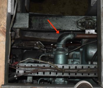

I'm currently getting flamed elsewhere for suggesting that this might not have been the best idea.
The poster has bought a non-original pump with the wrong outlet size: the upper clamp is securing the silicone reducer to just the hose.
What could possibly go wrong?
To be honest it would probably be fine, it’s not exactly high pressure.
But if that’s what he thinks is acceptable god only knows what the rest of the boat must be like.

If it was wrong - why didn't' he just return it and get the correct one ??

I’m just getting used to the Irish expression “sure, it’ll be grand”.
I’ve got a few of these “insert and clamp tight” transitions in my fuel lines. 🤷🏼
It looks like this is a modification from using a pump where the solid pipe connects to the water pump, to a water pump where a flexible hose connects. Follow the copper pipe round in a sort of anti clockwise way and you'll see a clamp holding it in place. It's not a modification because the outlet size is different size, it's because it's a completely different method of fitting which sounds worse but in fact is okay. The only thing that could be better is if the solid pipe was barbed (unless they've retrofitted something) to help secure the top (outlet) hose.

I agree, you only need metal pipes for going around bends...so rubber connector is fine...and the reduced diameter in the metal pipe probably isn’t much different than a rubber hose that is a little kinked from going around curves
