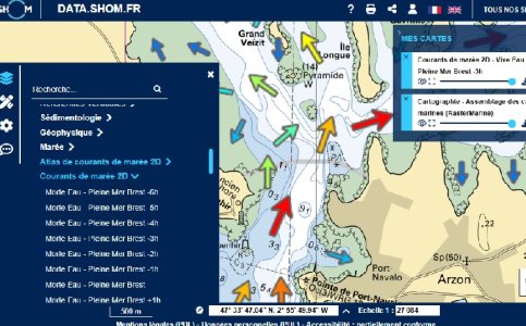

Does anyone have a link for tidal charts of the Golfer du Morbihan? All the physical ones I've found online are from vendors that don't supply the UK.
The above charts are from data.shom.fr , layer Courants 2D, hourly charts for springs/neaps wrt Brest HW

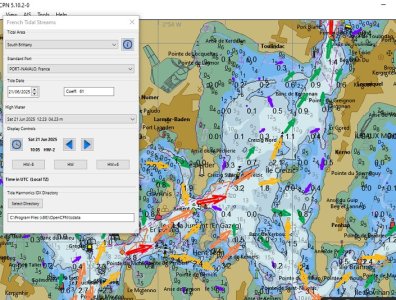

If you use OpenCpn, there is a nice plugin ''FR Currents'' which directly computes current speed for specific moments (range and time related to HW Port Navalo)
