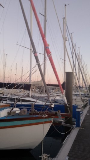

One of the best improvements you could make would be to fit a second furler inboard of the main forestay. You could then have a working jib and a 130% genoa. I watched a Rival 38 tacking up wind on the jib and main with this set up in a stiff breeze. Far superior to a reefed genoa for pointing ability, speed and lack of heel. But it's cost to make this conversion
You mean like this in the photo. Exactly what I have done with a "working" jib on the inner and the 130% genoa that came with the boat on the outer. Huge improvement, particularly tacking which was a nightmare with the genoa, and as you say if you furl it down to 100% the shape goes.
