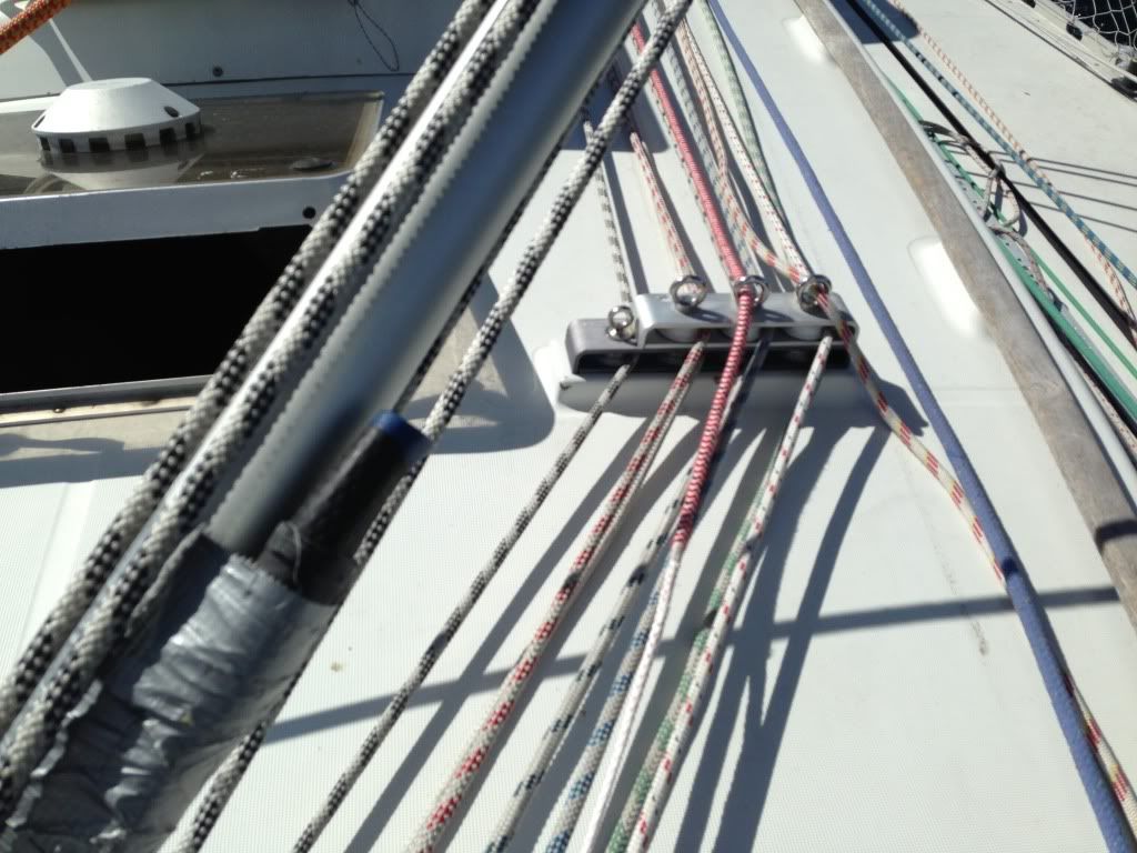

Have you considered another option.
Add a new clutch at the cockpit and associated hardware on deck.
Deck organizers can be stacked if necessary.
The extra hardware will probably cost less than a new winch.

Stacked Deck organizers
http://i372.photobucket.com/albums/oo167/knuterikt/Dyneema/null_zpsa86f4efb.jpg
