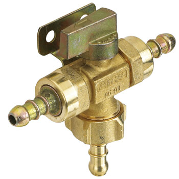

When I've played around with regulators they haven't worked "backwards" but, as they are designed to work one way, I doubt that it would be sensible to subject them to back pressure for any length of time. I'ld be inclined to play safe and either fit cocks in each line or, as already suggested, a changeover valve.
sailorman
21 May 2003
78,883
Here or thertemp ashore
http://www.gasproducts.co.uk/acatalog/Sirius_Manual_Change_Over_Valve.html
