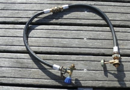

I have the open tap for the 907 (or the Butagaz cube) which can be connected to a few different high pressure hose lengths:
1. one ends with an inverted thread (usual 10-12kg bottles), the one I use the most. I can also fit a second 907 open tap (in some places in Africa they have big 6kg "Boubagaz" bottles with the same thread as Campingaz).
2. another one takes the open-tap for local bottles if available, one has to ask locally "I would like to use your gas bottle for soldering" to find the adaptor.
3. A third one is simply a cut hose, but never had to use it
edit
there are two pieces in each high pressure hose as every piece is only (at least here) available with one inverted thread connector on one end and a regular thread connector on the other end--> the two regular thread female ends are joined by a normal male-male connector.

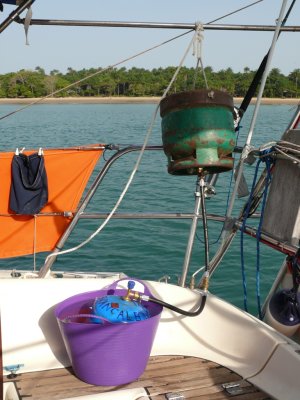

The 907 receiving bottle is in the water, when it reaches neutral buoyancy it will be filled with the correct amount of gas.

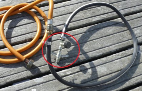

last picture, a local open tap fitting to draw gas from a local bottle
