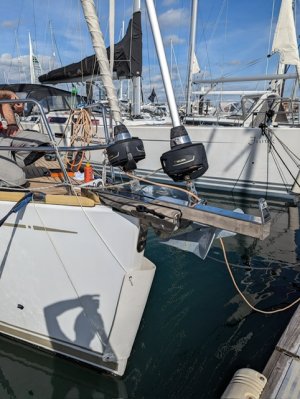

You don’t say your location but if in south I would also speak to Peter sanders for sail plus furler choices -there are really 4 players for furlers I suspect and prices vary. We had a bespoke spar created to fly the chute from via JTR in Gosport . Re the summer permanent rigging I would be more worried at wind damage ie unexpected unfurls when berthed) as opposed to uv but a sock might cover this risk. Ours lives quite happily in its sailbag until longer sails arise. Have just used Kemps for new uv strips on headsails and would compare their offering with Sanders. Clearly to reduce costs you might get far east made sails below shows bowsprit
