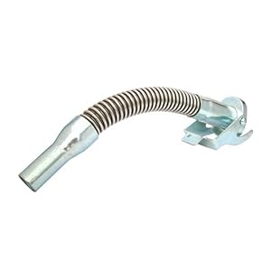

Strangely enough I saw these for sale today. Is this what you mean? (£8.99)
Nope, that's a standard jerry can spout albeit one with a flexible hose (by the look of it) - the superspout has a doubled back pipe with some sort of breather arrangement which stops letting liquid through once the receiving tank is full. That side of it works perfectly well, it's the seal with the jerry can that's feckin' useless
