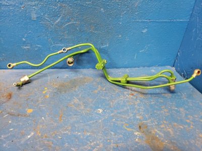

Hi following my ongoing issues with air in the fuel filter I am looking to have new copper lines made and need a source for the banjo unions on the leak-off pipe. They require the fitting (nipple ?) for brazing the pipes on. Any suppliers or pointers gratefully received. Engine is a VP MD11C
SSG
Picture for reference:
That's what I did, I think that they are just soldered on, or it could have been brazed on.
But they came off with a torch on a small Campingaz cylinder, not too difficult, just hold the banjo in a vice and using a mole grip (hand vice) to pull the tube out.
Be careful you don't mark the faces of the banjo, I used aluminium jaw covers to protect the banjos. The tube is scrap, so you don't have to be careful with that.
I also used copper pipe for the new ones and soldered them into the banjos.
Soldered melts at around 300C, and copper is a lot easier to bend and a lot more corrison resistant then steel.
They were still serviceable years later when I sold the boat.
