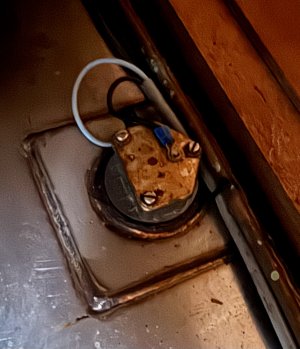

Hi folks,
My fuel level sensor is constantly reading zero (with fuel in the tank) so i think it’s tine to replace it. Issue is I’ve not seen one like this before - does anyone recognise it and have a recommendation for replacement?
Thanks!

Great, thanks - that’s a great find! But ooft they are not cheap! I wonder how difficult it would be to retrofit a more standard type with the 5 hole pattern.

Have you any time removed the sender unit ? Once you do that - then you can look at alternatives ...
I had a strange sender on my tank - which never worked - think it was hang-over from its 'truck days' ... boat had no display. I took it out .. measured ... found that a standard float arm sender fitted - bought a set of arm and display .. fitted and all good. (Someone - later though managed to break the display glass - which knackered it ... simple swap out for new).
Most senders seem to conform to a standard mount size. Take note if you do swap it out - there are basically European and USA versions - they do not work with each other !!
