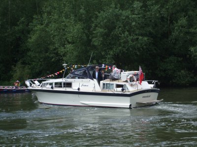

Hi, OG. I bought my Freeman 33 (Sportsman) in '97 - and it had all the issues that you mention - and some! Osmosis, clapped-out engines, dead heating system, dodgy old batteries etc., etc. I did want a project, but even I feared occasionally that I'd overdone it! However, it was the boat we wanted - able to cross the Channel or go through Osney Bridge on the Thames. They were well built, solid (mine goes 7+tonnes) and beautifully trimmed and finished. Their flaws were the gelcoat quality, the osmosis and the (then trendy) angular windows. We had the osmosis dealt with and all windows out & re-built in '98 and over the years have brought her up-to-date generally. The normally beautiful Freeman interior woodwork had been badly mucked about by previous owner(s) and they'd used Elm - as Dutch Elm disease was then rampant. This did make repairs and additions a bit more difficult as Elm is hard to find nowadays. There you go! We paid c£25k for her and an equivalent new boat today would, I expect, be north of £200K. We've had our moments with her, but now she's a lovely, '70,s classic but with all mod cons: New Nanni engines, gearboxes and shafts; LED lighting throughout, double cabins with en-suite at both ends, new Eberspacher heating, new galley etc. In '21 I re-wired the main battery systems and fitted LiFePo4 batteries etc (transformative, btw). All in all, we've probably spent north of £100k on the boat, but she's a joy to use and much admired too. Probably worth c£40k now, so over 27 years, we'll have 'dropped' about ££k/pa in maintenance etc. I'll let others do any math on this vis-a-vis a new or newer boat. Even a really well-presented 'original' one now is a 50+ year old boat, so there are bound to be costs, seen and unforeseen. You pays yer money and takes yer chances.......

Hi - and, yes you are correct. They started making them in about 1978 I believe. My only defence is that my grey matter is (very) considerably older! We celebrated Drumbeat's 40th birthday in July last year, so 40+ years old.
