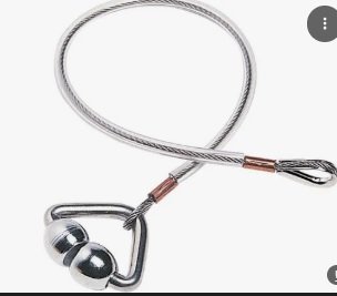

There may be two (usually there are, in particular for foiled sails routinely changed): one is often called pre-feeder and is tied with a length of line say 30-50cm to somewhere near the headstay attachment, its purpose is to lead the bulk the sail near the stay. I personnally prefer those prefeeders having two rollers to those being solid horseshoe, Example:

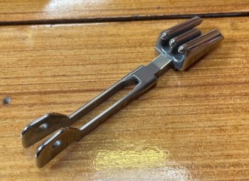

The second one is the proper feeder which is attached to the aluminium profile where the luff enters it. This second one can be permanently attached to the tube, or removable.
I have this one, it can be snapped on/off on the tube

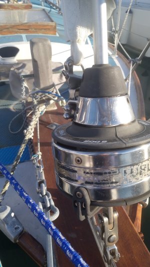

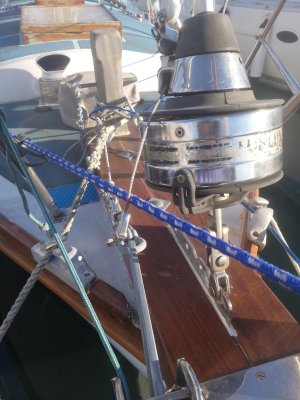

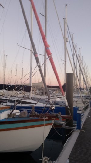

The photos show my 2 forestay set up and the pre feeder in the Furlex on the inner. These seem to vary from model to model and mine is on a flexible tether that retracts. The harken one I attach when needed with a line to the drum and set at the best height to keep the luff lined up. As you can see the sail has to go over the pulpit then up to the feeder on the foil and the Harken gizmo makes sure it is lined up.
