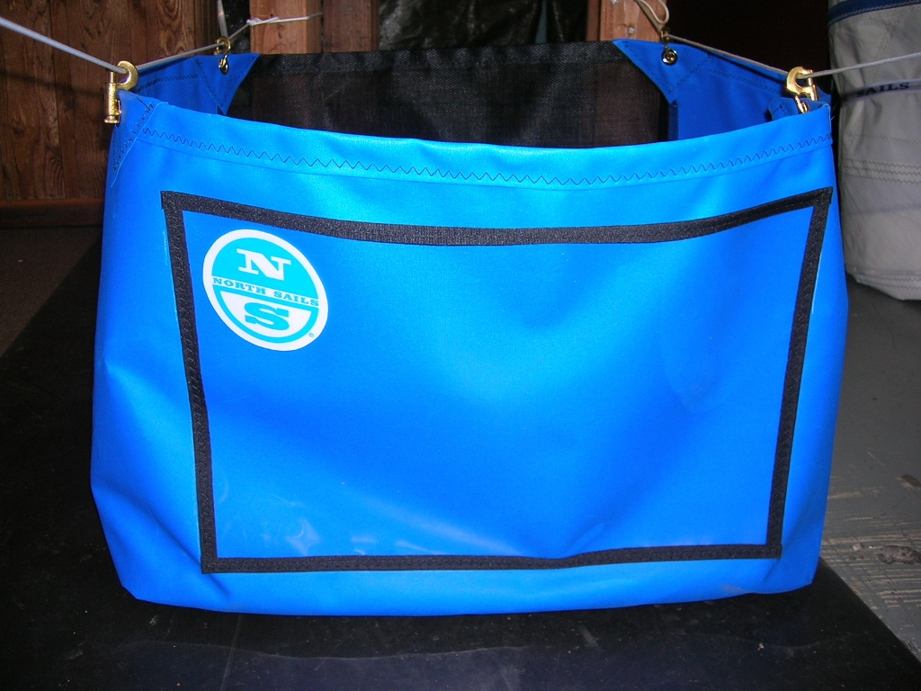

But how did they hold the bag open in the companionway? Thats really my issue. Its the best place for us to do the repack but the problem is the soft floppy bag, holding it open preferably so that one man alone can repack.
The normal way is to have the bag on runners.
So two lines running just outside of the hatch opening forward, so that once it's in the bag it can be shoved forward out of the way.
Still don't think this is an especially winning idea on a starlight though. The hoist from out of that bag in the companionway has got "bad idea" written all over it in a boat this size I think.

Wouldnt dream of trying to launch from the companionway - just too many snag points between there and the forestay. But the above looks possible as a way of holding the bag open to repack. I will investigate.

I tried the system pictured by Flaming and it worked well. But this week will be the real trial since the kite has been left in the bag just as it came down. Some crew swear it wont be twisted when we launch - we shall see. I am not confident.
But the approach at least for dropping is much better than dumping all into the cabin and attempting to pack down below.
