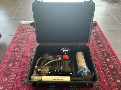

I purchased a secondhand Katadyn survivor 40e which I have now made it into a cased portable unit and I am just finalising prior to testing as my possible solution.
It just now needs two right angle pipe fittings into and out of the prefilter which has slotted mounts to allow its easy removal for filter change outs and an external Anderson pug with switch to complete the unit.
With low power draw at around 12v 4 amps my solar system will easily cope with the proposed 2 hours a day usage to produce around 10 litres which is slightly higher than our long term tested 8-9 litres average use for the two of us.
The pelican case knock off was cheap at A$100 new and the Katadyne unit with a new unfitted membrane, seal kit and lots of other spares and replacement filters and pickling solution was $2,000 for a 370 hour unit deinstalled from an older cruising yacht about to be sold where the owners felt it wouldn’t add extra value to that sale but had been in regular use.

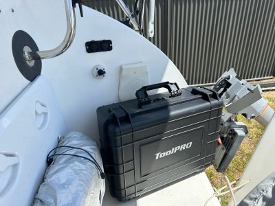

It will store in my stern generator box as that manufacturer fitted location is now no longer needed due to my new large solar array. The operational location is immediately behind this on the swim platform secured by the case handle to a Bimini support and the inlet and waste water tubes directly over the stern.
I had to cut a hole on the base for the motor to slightly protrude to fit it all in the smallest possible case but this also provides the space for the inlet and outlet water tubes whilst the motor end still doesn’t touch the ground with the case upright due to stands on the case to protect the hinge.

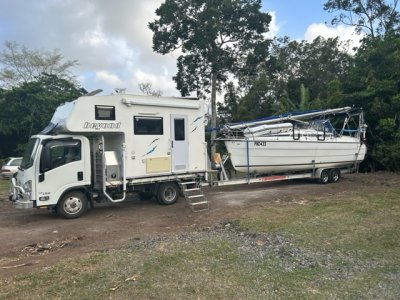

Last photo shows the swim platform accessed generator locker which it snugly fits inside on one side still leaving room for our small Honda eu10 and a fuel container or more likely just general storage as our last 2 months trip never required this backup power source despite cooking by induction, compressor fridge and separate freezer and our 240v hot water service used occasionally for showers. IMG_2400.jpegIMG_2411.jpegIMG_1485.jpeg

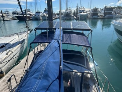

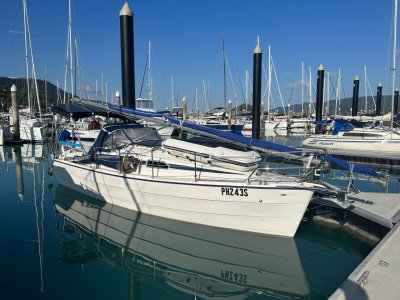

Our trailer sailer is only 8.5 metres long and 2.5m at its very widest point. Photo here shows her carrying 720w of solar panels comprising 3x180w mounted fairly unobtrusively directly on top of our Bimini and a further identical tiltable panel on the rear targa bar supporting the rear of the Bimini and a variety of other functions
With a further 160w hard port starboard tiltable panel over the cabin roof and now just purchased a further 440w of roving fold up flexible panels which mount on the upturned dingy, secondary at anchor cockpit covering fold up Bimini and on the dodger and mainsail bag we have managed the well over 1000w of solar panels on a both quite small and trailerable yacht.
The hard panels have just survived over 5000 kilometres erected whilst the yacht was towed on its trailer for southern Australia to the Barrier Reef and return.
Yes it doesn’t have beautiful classic lines but it doesn’t look like an ill conceived mess either.
The panels also fold to allow the yacht to be derigged for trailering whilst still on water which took quite some puzzle like figuring out of angles and support bar adjustability.

Not far enough for next years planned 3/4 months without the ability to resupply hence my almost completed Katadyn survivor in a box portable water maker in progress now.
This was taken a few days ago and it has had further modifications since then and is about to be tested for performance , noise and and general usability.
The case is now padded top and bottom and sits on special noise and vibration reducing feet pinched from a dead Honda suitcase generator.
