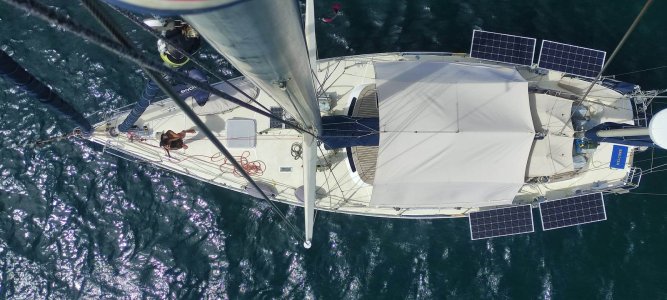

We have a rainwater collection system on our boat. We fitted fabric gutters to the over boom sun cover. Our record is 500 litres in 2 hours in a tropical downpour in Curacao.
It's worth noting how dirty rainwater is. We use a 1 micron filter in a 10" clear housing to filter rainwater before it goes in the tank. That filter gets really grubby, really quickly. It's a very good idea not to put rainwater in your tank without good filtration

Not dissimilar to us except our filtration is gravity. 1" diameter pipes off the sun cover run into a tee then 1" to the filter before the tank filler. It's amazing seeing the 1" pipes running full bore into the tank in a heavy rain storm. We don't use the system often but it's convenient when there is little sun about for solar but plenty of cloud about for heavy rain.
I saw a great system on another boat - deck drain at the lowest point with a y piece under - first few minutes of rain and its diverted to overboard to take away any bird muck and dust and then switch over to filling the tank via a gravity filter.
An American with the same system commented that theirs doubled as their main tank fill also, so that when asleep or off the boat they could set it to divert overboard so no one could drug their water to rob the boat or murder them ... it must be very stressful to live in such perpetual fear.
We have a dog. No way I want to collect off the deck. The sun cover is amazingly effectively.received_231663256251077.jpeg
