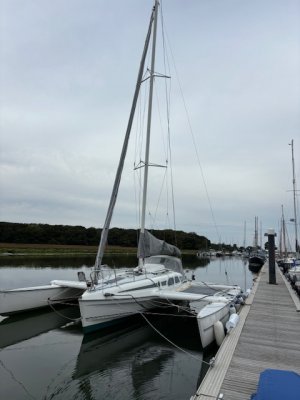

This is one of the biggest road transportable ones. You wouldn’t call it a trailer sailer, it takes about 3 hours to assemble on the teailer after towing, and needs three humans with hair on their chests to do it. But it’ll sit on the trailer or trolley, folded, assembled, ready to go. Just it’s too wide til you take it apart, to traill.
Advantages, as you say. Light, trailable, low draught. Very, very fast. Its a rare sail not to see double figures, not unknown to see 20kn, though you won’t need the log to tell you that. Every part of your anatomy will know. Accommodation, compact. Like a Contessa 32 with just a small area of standing headroom. But we have all other griwn up facilities, and a really good cockpit tent. We love ours. Do you want a sail?

Er, it folds for marinas, has a fully shaded cockpit, and I guess really isn’t suited to those who are too idle to raise the mainsail. But if you do, ypu won’t need to moter. It sails to windward rather better than any 30 ft mono, and sails off the wind better than any 50ft mono. The cat, sure, has all that accommodation, but will most certainly cost you in a marna, not be road transportable, and unless ypu have very deep pockets, will sail like a barn door.

Folding tris exist further north too. Both Angus and us have Dragonflys. You need to see a Corsair too. Another approach to the folding bit.
