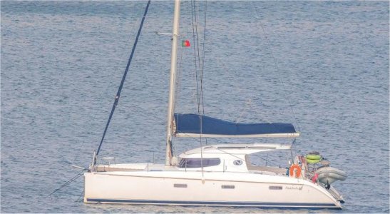

Yes, more stability and more sail area. You are right, goose winging the code was not ideal but combined with the "poled out" genoa it demonstrated we could make good progress downwind in the direction of our intended destination, clearly if we had been hit with a gust of 20+knots it would have take a while to clear the set. Our ability to be able to set both bow guys and sheets to both clews will give a a very stable set for the spinnaker. A couple of things to bear in mind (guessing you are not a cat sailor?) the foredeck of a cat is a much, much friendlier place to work than a mono and if you motor briskly ahead (7.5 knots for us) whilst you are dropping and clearing up the you reduce the apparent wind dramatically. So when it comes to dropping the spinnaker because the wind has edged up to the top of our range, it "should" be simply a case of start the engines, go forward on the nice spacious and stable foredeck, spike one of the clew guys/sheets, bring the motors up to full ahead and then snuff and drop and tidy up. "She" is a Nautitech 40 S2 from 2008 and you could call her an old school cruiser, narrow hulls, fixed low aspect keels so she can take the ground and a modest, sturdy, low aspect rig. image attached
