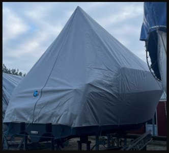

We have a tailor made cover for the flybridge. I added a couple of poles plus some rods and strips to keep them upright, but it's a struggle to put up and I hesitate to take it down for the same reason.
We have a tailor made for winter storage for our 30' Fly mobo. Breathable, snug and light, zipper in the rear to allow for easy access wintercover.jpg
