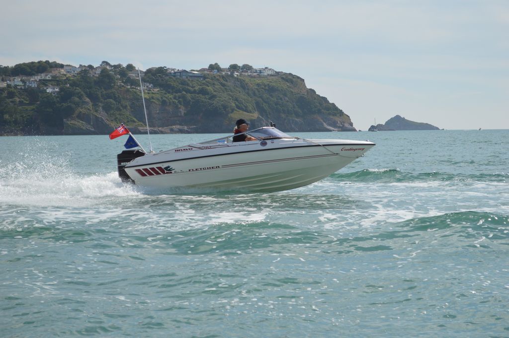

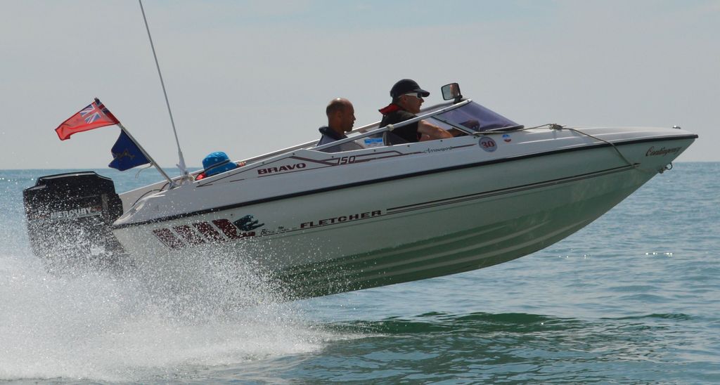

Here's ours:
Great picture. Amazed at how solid the thing is in a chop. Superb wee hull. I'm wondering about the prop set up. The rev counter doesn't work. I have a 19" pitch on it. Was doing about 42 mph trimmed up and light, with the 90 hp. How does yours compare and how the hell did you get the photos on without using a link ?
Yours an Arrowsport 150 ? Looks the same hull. This is an Arrowsport 16. I'd imagine it's identical.
Yes, they played a bit with numbering over the years - she's 15'9". Pics are linked ;)
I get 36.6kts top speed 2 up with 60l fuel (stern tank) just fitted bow tank, so hoping for more!
Same speed with 19p, 20p, 22p & 23p 4 blade! Can't yet break 40kts on gps! Bank in in a few weeks, so lots more testing - the 4 blade ss Trophy has loads if bite, but tries to corkscrew the boat when you land, so need to be quick on helm! ;)
Mmm. That's what I'm worried about. Hard to tell what it's doing. It's at least 5000 anyway. What should it be ? About 5500 ? It's a black max 13x19"P. Had a solas stainless 19" on it, but was in bad shape.
Having had a few boats similar sized, can't speak highly enough of the laser 2 prop. Amazing things.
37 knots is pretty brisk. Well over 40mph anyway.
