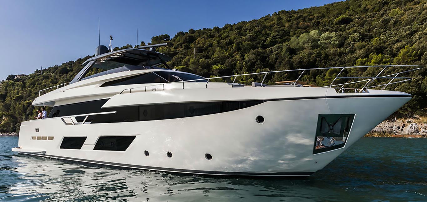

Load Line Length. This is invariably shorter than LOA. you can google it but here is a rough guide:
Look at a side profile line drawing of your boat (ignoring fin keel, if awb/sail boat)
First, draw a line the full width of your sheet of paper parallel to water line, but level with hull bottom - the bottom v of a planing mobo for example (actually it is the inside of the keel, so with a GRP boat say 50mm above the outside skin of the hull along the keel, depending on the build detail).
Second, draw a parallel line, also full width of your paper, that is along weather deck. On a typical mobo this is the aft cockpit, so quite a bit lower than the gunwhale. On a modern open transom sailboat or jeaneau/bene with 1/2 open transom it is the same. On some sailboats with solid transoms it will be toe rail level
Third, draw another parallel line that is 85% of the way up from the first line to the second line
Measure the length of boat along that third line, multiply by 96%, and that is LLL. So a sharp raked bow has a lower LLL than a plumb bow, AOTBE
There is much more to it than this - you have to read the rules. There is an alternative rudder post measurement (often irrelevant because a good designer will make sure it is when you're close to the 13.7m or 24m threshholds), and you get into removable nose cones on boats over 25m LOA which are "tricks" to keep a boat under 24m LLL, but I wont go there in this post. Bottom line is that you can stay under 24m LLL in a 27m LOA boat, and a 13.7m LLL boat will be typically around 14.5 -15m LOA.
When I say LOA in this post I'm not counting the pulpit overhang.
This is very rough guide - it is googlable but gets quite hard to read as it is not the clearest of rules.
Edit: This picture shows the bow of a ferretti 920 (93'6", 28.5m iirc) which has a separate bow moulding to get under 24m LLL. You don't actually remove it ever (at least not deliberately :D) but it can be removed technically, so is not part of the hull and therefore doesn't contribute to LLL. The anchor plate obscures much of the joint but you get the idea. So LOA can be quite a lot more than LLL and designers think about this when the 13.7 and 24 thresholds are relevant
