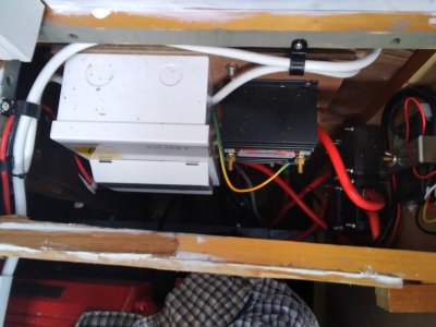

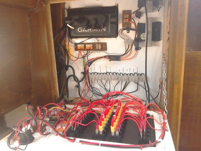

12mm ply is commonly used for this. I use CT1 to attach to GRP and screws to ply bulkheads. I tend to make the panels up in the workshop to get the layout right, then paint or varnish them before attaching. couple of examples in the photos. The first is the shorepower CU and GI. lower down is another panel for the main bus bars. The second one shows some smaller panels that put related connectors close. These are all on ply bulkheads so screwed as I try to avoid that but I have done a couple like that

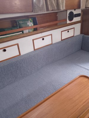

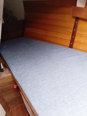

Yes. Couple more photos showing the use of CT1 In first one the mini bulkheads for the bookshelves are bonded to the GRP hull and in the second the battens that the T&G lining is secured to. I usually use masking tape to hold in place while the stuff cures.

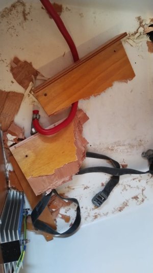

I recently moved my bow thruster battery to install a freezer. The original builder battery installation had a base made from 8mm plywood held down by 4 screws and a single zig-zag of adhesive. Screws came out easily, but despite a lot of trying I could not get the base off without destroying it because of the adhesive.

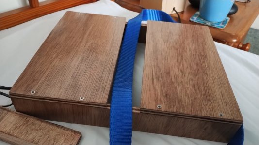

I made a new one. When installing it I used screws and CT1. I applied the adhesive only near the edges because if it needs to be removed again that can be reached with a blade to cut it. Adhesive in the middle is impossible to do anything about.
