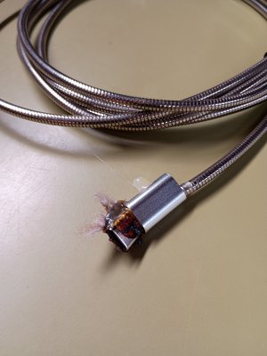

I was well offshore when I smelt burning and faint smoke in the cabin. Turned everything upside down and was ready with the fire extinguisher, I couldn't find it and it eventually went away. In the evening I found my usb c cable melted to the side wall fabric covering. I bought it in Ale-Hop but people on t'internet say that it doesn't have to be Chinese rubbish for this to happen.

Plenty of examples of Apple lightning cables on fire on the Internet, and they're some of the most expensive cables money can buy. It doesn't take a lot, dirt, corrosion or internal damage can all cause this sort of thing. The scary part is that sometimes it happens next to the phone which has a lithium battery inside. Unrelated but I feel compelled to post this video of a dog biting a portable USB battery charger and burning it's owners house down :eek:

It does "look" like a good quality cable. Not one of the moulded things you get thrown in with various gadgets. A good idea to run your fingers over things occasionally, see if anything's hot.

I still restrict my USB cable power .... despite C cables saying they can handle high charge rates ...
Only time I go above 2A via USB is when the item powered cannot be powered at such level ... luckily not many.

They generally only go up to 3A anyway, it's the voltage that changes to give extra power so usually on a boat you're limited to 12Vx3A regardless of product support for more than 36A. There is a spec for 5A 100W charging but that would need a different (thicker) cable.
