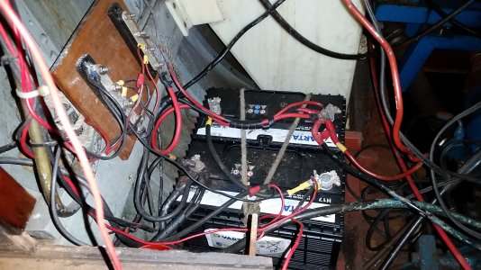

Reason for fire was an elderly start solenoid with dirt that tracked across between positive and negative. (Still hard to understand).

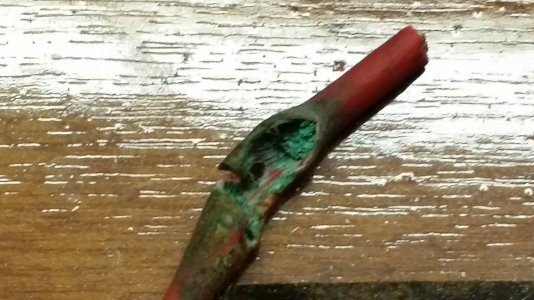

Consequence;- prolonged anchor recovery caused continuous high current at a through-bulkhead connection (which was insufficiently tightened and made with stainless fittings).
