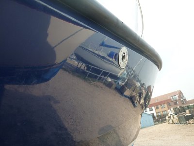

Farecla G3 is good stuff! It’s what I finished the Jotun Hardtop AX with on my boat after flatting the final coat with wet n dry
I use Farecla G3 every season, althogh there are different types of G3: liquid, paste etc. I think standard G3 is more abrasive and good for removing scratches and restoring dull coloured gelcoat. Water mist spray a square metre, dab on a few small blobs of polish then polish off with a lambswool mop on low speed. Wipe down with a duster when dry. You can then go for more finishing compounds but I don't usually bother.
