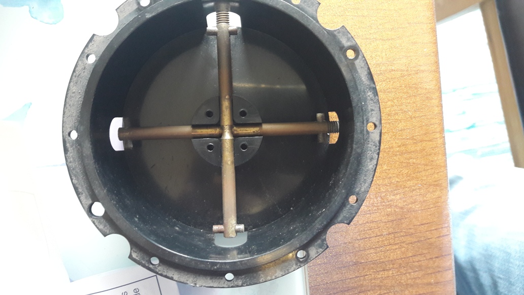

Thanks for all the suggestions. I had a brainwave and dismantled the compensator on the old compass. Turns out I have completely misunderstood the way it works. One full turn puts the adjuster back where it was and 45 degrees movement of the adjuster has more effect than 90 degrees of movement. Inside it looks like this:-
The little bars through the ends of the brass rods are presumably magnets which rotate with the rods. I thought the adjuster was a lead screw moving a magnet horizontally below the compass - Wrong!
So I'm off back to try again this time turning the adjusters 30 degrees at a time.

Spot on - thanks!
