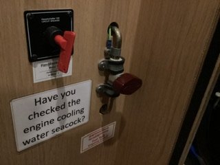

The fuel shut off valve on my Bavaria 33 Cruiser has failed open (the engine continues to run, regardless of the position of this switch).
I can’t seem to be able to source a replacement. Does anybody have any idea where I might be able to find a new one of these, or, failing that, a suitable alternative ?
In reality, is this valve a really vital piece of equipment or should I just save myself the time, money and hassle ?

Can't help with your question, but it's good to see important things accessible and labelled. I'd definitely keep a valve fitted
Regarding the problem, the spindle to the ball valve can shear or round-off. Not repairable, a replacement shouldn't be too expensive.
You’re likely right and need a replacement..but forgive me for asking…how much running time did you let elapse, before assuming that it’s at fault ?
It’s incredible how long a small diesel will run for, just sipping at the residual fuel in the system after a shut off valve.

What is the vertical position of the tank wrt to the engine? If it's higher, or the fuel level is higher, then you must have a shut off valve or it may be a bilge full of diesel at each change of filters.

Yes, Roberto, that’s what I was particularly worried about as I was changing the fuel filters today. I tried to disconnect the fuel feed pipe from the tank, but it wasn’t about to give in too easily, so I thought I’ll just check again…….
I ran the engine for a few minutes them flicked the switch closed and hey presto, the engine died after two or three minutes. I did it twice just to make sure and it died again. It did take awhile but it definitely cut out….eventually (Thanks QBhoy).
So I was able to change the fuel filters with no drama.
The strange thing is, I’m sure I got into the marina after a days sailing this summer to find the fuel shut off had been shut all day! So perhaps I have an intermittent fault. Now I have lost confidence in the valve and will probably change it anyway. Intermittent faults, aren’t they just the worst 😡❓

I expect it is partially blocked. The problem with the valve is that the hole is too small - enough for the fuel flow rate but not the full diameter of the pipe. You won't get a fuel leak if you remove it as the pick up point in the tank is lower than the valve. The one I linked to is 1/2" and the pipes are 3/8" or maybe 8mm.
