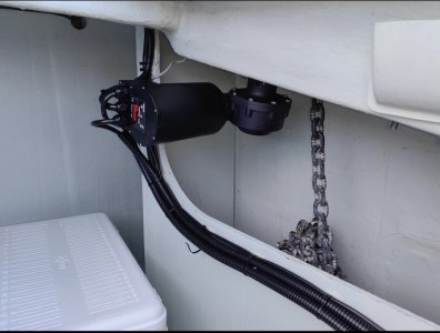

Thank you, all. I'll definitely just replace the chain and I'll check the gypsy before buying. 80M will probably be enough but if I think space may not be a problem I may just buy 100M "to be sure, to be sure".Screenshot_20240315_082808_Chrome.jpg

10mm chain weighs 2.3kg per metre - it will take up room and even 80m will need 'something' mechanical to move it. The amount, length, you are considering is, I assume, all in the bow

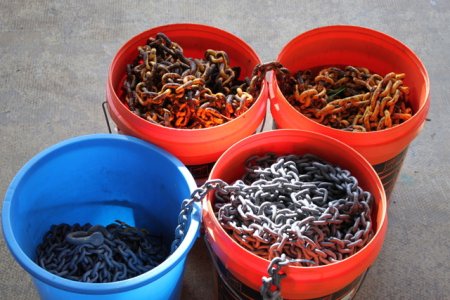

Its a different scale but this is our 50m of 8mm chain, in the rear 2 drums and the new 75m of 6mm chain in the 2 near drums. I stress, changing chain size is expensive.
