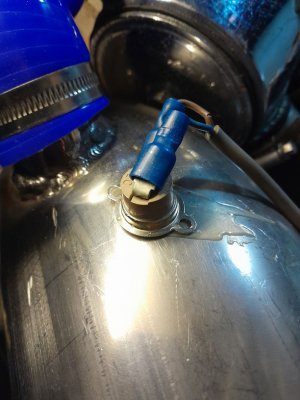

Exhaust alarm sensor
ianc1200
6 Dec 2005
3,626
Frinton on Sea
I managed to break the spade connection on one of the sensors, anybody able to recognise this? (edit to say this is the one from the port engine, the one i didn't break. Also can see there are letters/numbers which might identify it so will look again)
Temperature-sensitive bimetallic disc​
The switch is designed with a temperature-sensitive bimetallic disc that is the actuator for the thermally and electrically isolated contacts which open when the ambient or surface temperature increases to the operating snap point of the metal disc.
There are different operating temperatures which will be indicated on the unit

Many thanks. Certainly do look like them.
Hi Colin, the switch has only a item number, but the spec from the page noted above says 0 - 180 degrees C, and an electrical rating of "16A/250V, 15A/125V, 10A/250V". Not sure if it should be used with 12V, but clearly is.
Any recommendations re type of glue to use?
would clanp the 2 lugs on to the elbow using 2 stainless steel worm drive clips to allow easy removal
It's an alarm, not a readout. Will sort crack in wire. Have found the actual device is

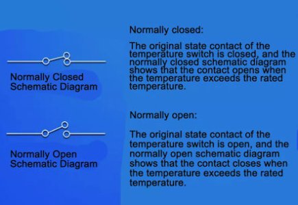

Normally Closed KSD301 Automatic Reset Thermal Switch High Temperature Protection
seemingly sold by the shipload, so seeing if similar spec switch available from the RS Components site.
Would it be a normally-closed? That's an odd way to do it as unless there is some intermediate circuitry the buzzer will sound immediately. A Normally-Open switch will close at the rated temperature, allowing voltage through a buzzer, light or whatever. Just sticking my nose in though!

It appears from the page you quoted that they can supply any temperature between 0 and 180 so you need to know at what temperature your ones are . For example, if you buy from this supplier you have a choice of 23 different temperatures. KSD301 Temperature Controlled Switch 250V 10A Normally Open/Closed Range 40-190℃ | eBay UK
Absolutely. Unless your adhesive will withstand the maximum temperature your exhaust could reach, if your engine overheats due to a lack of raw water flow the sensor may activate the alarm or it may fall off before the alarm sounds.
We've been thinking this through also. The buzzer goes off if there's a break in the continuity. I've disabled it by connecting the two wires together. But does "closed" mean there's continuity when the danger temperature not reached? And it "opens" ie breaks the continuity, if it does reach that temperature - or the other way round.
Edited - Colin's (Plums) EBay link had the answer.
Yes

Re temperature - I've got one off now. The backside of it has "A/ 060 - 15 4308"
The manufacturers detailed spec says it is made for an electric kettle, A is contact type, 060 is operating temperature, 15 might be the temperature tolerance, can't make out what the 4308 means.
T24 KSD301 16A 250V Bimetal Disc KSD301 Thermostat For Electric Kettle about half way down page.
But what interests me is the 060 which I'm reading is when the switch opens/continuity is broken/alarm sounds.
The dashboard has a sign saying normal operating temperature is 85 - 93 degrees C, but that is the engine temperature, not the exhaust temperature which has been cooled by seawater. On another boat I have, I took out a direct cooled BMC 1.5L and replaced with a Nanni 62hp freshwater cooled with a heat exhanger. When the BMC was running I could barely put my hand in the exhaust water - it was so hot, and was suprised how cool/cold the Nanni exhaust water was. Yet to try these Cummins but am guessing the exhaust won't reach 60 degrees C. Will try soon but in the meantime at such cheap prices on Ebay use the 60 degree one and see how it goes.
