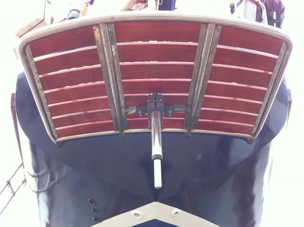

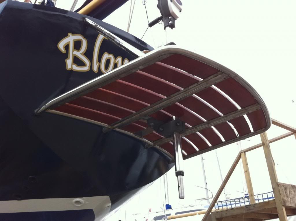

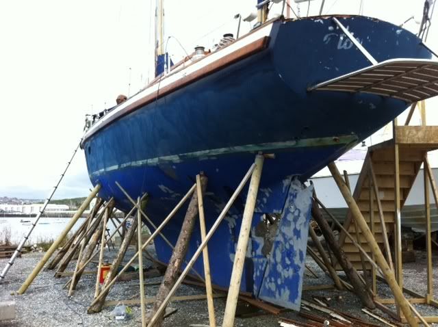

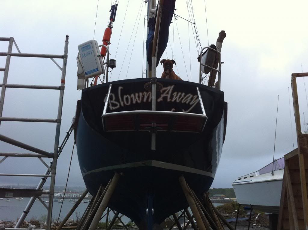

With your swim platform, I built something similar around the hydrovane on the back of this old tub , are you supporting it externally ? Our RIB got caught under the platform from the wash of a passing ferry, when the frame came down hard onto the RIB it left a small but noticeable bend in the base of the platform that i have yet to straighten out , god knows how much force that took !
we have (royal we)…well ok … I HAVE also clipped a pontoon with it trying to get off a wind on pontoon in Camaret, sometimes I wish I hadn't fitted it , then of course I go for a swim off it and alls well with the world.

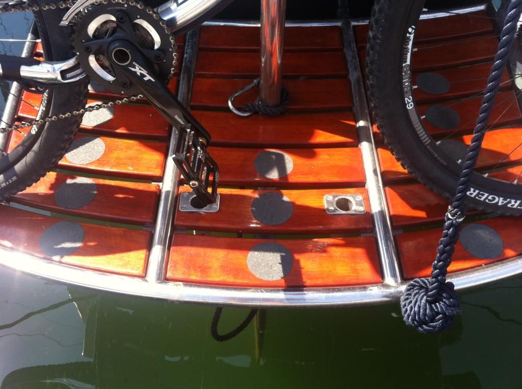

more recently we had a better ladder made up, the sockets that fit into the teak slats also bolt through the stainless frame underneath , they were made the same size as the passerelle socket so when the ladder is out and stowed we can fit the passerelle onto the swim platform , which the dog discovered was an easy escape route, jump onto the swim platform , up the passerelle - he ran through the restaurant hounding people for food and then into the kitchens before being "arrested" and tied to a railing outside, so now Ive had to extend the canine concentration camp netting to the stern as well (removable)

That's a decent sized swim platform, close to what we're looking at. We did have a swimming platform once. It was thin enough that when my gearbox failed and I took out an electricity pedastal in Bodrum marina it bent out of shape. It was a **** design anyway. I'm still in two minds about the support of this platform. With the ends fixed inside the lazarette it should be good enough but I'm a big lad and those upper struts like yours may still be an option. Makes a great bike rack, btw. Love that!

If I could Id change mine slightly and bow the supports further out instead of having them vertical , they only get in the way occasionally but often enough to wish id penned the design differently , as for the bike rack , it works exceptionally well in the marina , beyond that the bike is stripped ,oiled , bagged and stored in the spare cabin with all the other boys toys :-)
