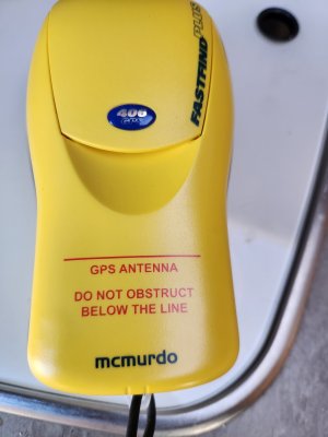

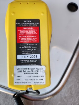

Is it worth while having an older EPIRB serviced, current one ran out 2021. If so can I register it through Ofcom as boat is new to me.
Thanks

I have just replaced the battery in my Fast Find. I think it is worth it and good enough.
Having an AIS would be useful but I am not going to pay more for an AIS capable PLB. It is a personal choice if you think AIS will increase your chances of recovery.

How much is the service compared with a new one.
I had a new battery put in my plb a year ago or so for around £90 compared with over £200 for a new one. The replacement battery had a 10 year Iife.
I used Home and found them very easy to deal with and spoke with the technician who did the service.

Your old EPIRB will not have GPS and so pinpointing location will be far less precise. Now things are different in UK but I think a new EPIRB with GPS and new battery might be a good idea. ol'will
I replaced the battery in my PLB. myself. It's not rocket science and I trust my own work as much as any technician. It was around £10. I'll probably do it again this year.
